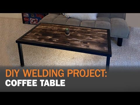

A modern, welded coffee table is a perfect way to upgrade any room in your home. Get the steps for this project - plus some tips along the way!

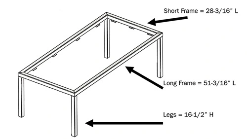

  • Butcher top: 48” L x 25” W x 1-1/2” H
  • 4 – 16-1/2” L x 1-1/2” W square tubing
  • 2 – 51-3/16” L x 1-1/2” W square tubing
  • 2 – 28-3/16” L x 1-1/2” W square tubing
  • 10 – 1-1/2” L x 2” W tabs

Material Dimensions:
Coffee Table Material Dimensions White
Coffee Table Project Plans
