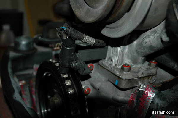

    First project was this using 0.024 solid wire and CO2.
    Nothing fancy, just 2 pieces of 1/8" x 3/4" angle iron welded together to make a mount for a VR sensor for a Megajolt DIY ignition setup. Hardest part was welding the 2 nuts to the back side of the mount for the sensor mounting bolts.

    Just use more foil tape. Looks great.

    70S6 wire won't work real well on the alum/mag mix in the VW case
