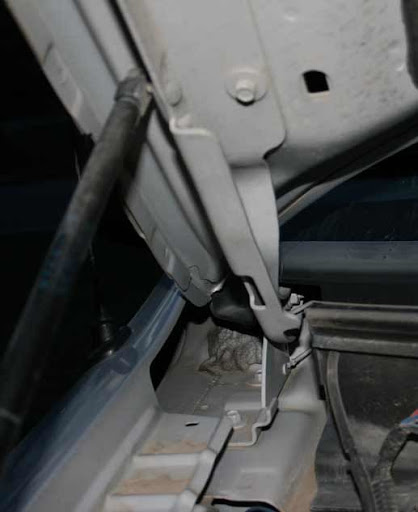

    Ok I finally got the pictures today. Here's what I got to work with:
    This is under the hood looking at the passenger side hood hinge

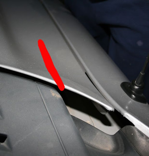

    And this is from the windshield looking down at that area. Nice that there is a factory gap right here so installing a mounting bracket here should be pretty easy. The gap around the hood looks to be about 1/4". I guess some 3/16 plate would work pretty good right here.
    I'd love to make this out of tube just to keep it from looking red neck. I need to find someone with tube bender local.
